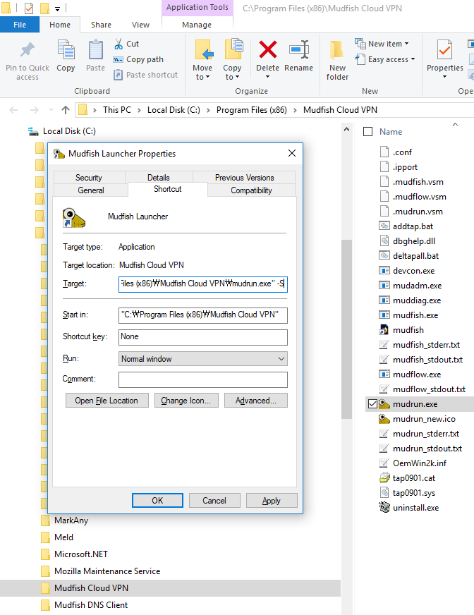

- run Mudfish with option lowercase `-s`
then access to https://ui.mudfish.net:8282
- connect with Mudfish DNS Client If Mudfish DNS Client doesn't work,

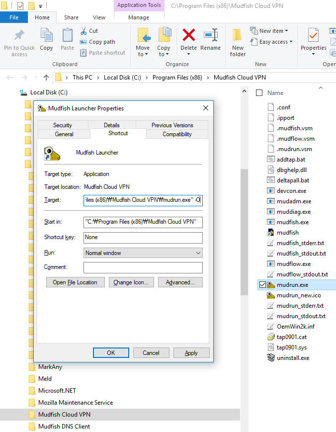

- use capital `-O` option to change the Mudfish's working method as refer Firewall - Mudfish Master Server
