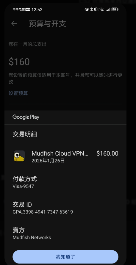

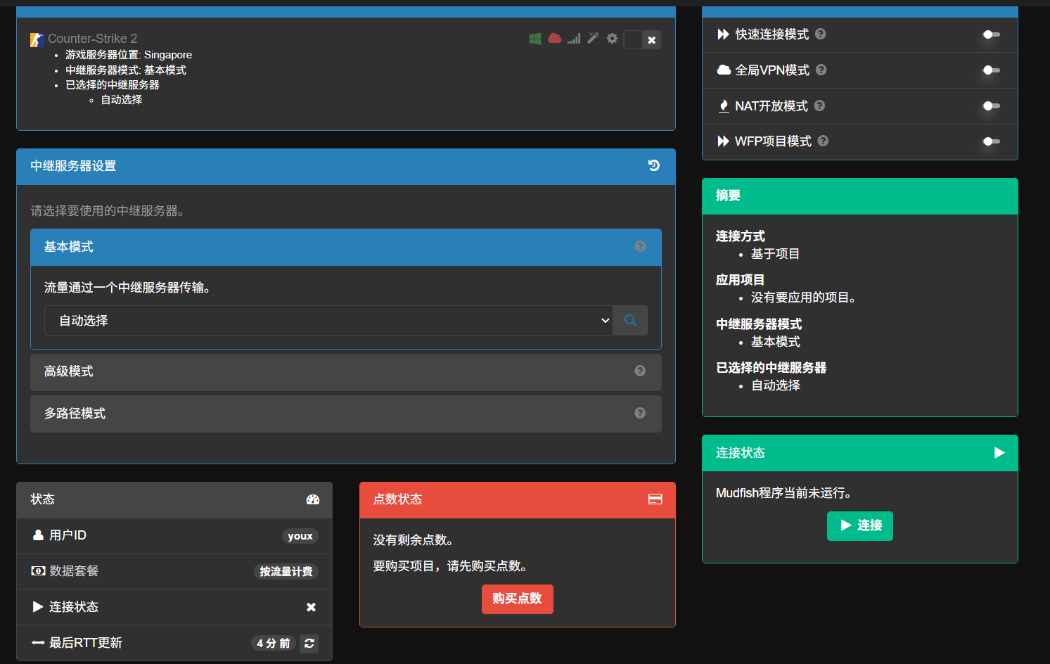

i am missing credit too.
@bada0512 Sorry for this inconvenience… I’d set a trial credit now for your account.
So I think you can use all mudfish nodes and features for a while. Please let me know if there are any problems or questions.
