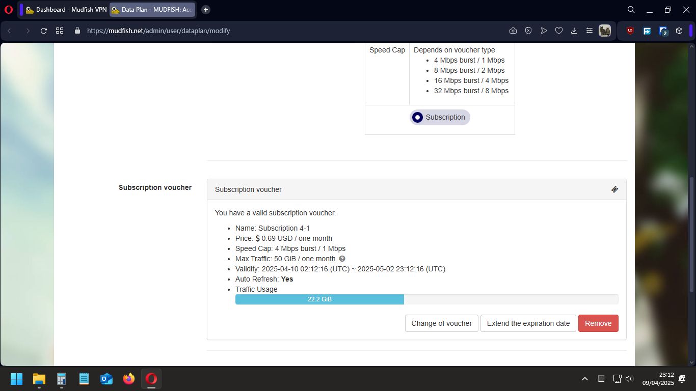

Ok hello again.I have confirmed that traffic usage under “data plan” continues to increase despite not playing Mu Online, which is the only game I configured in my items.
Here’s two screenshots just after closing mu online. You can check the time.:
after 1 hour:
again, any help? Is this a problem with my computer or the mudfish server? because I don’t know what else to do.
and while I create this thread it keeps going up, lol:

I’ve already installed GlassWire, and in what section of the program do I check traffic? And i have access logging enabled. Here’s a screenshot:
i have checked, viruse, malware. Nothing. Traffic log is normal, no rare ips or so. I think is not my problem honestly. I’m providing more evidence that the same thing is still happening, along with a GlassWire screenshot showing that, during the capture period, no process was consuming data through Mudfish.
+200 Mib doing anything:
If you need more info just tell me, thanks.
