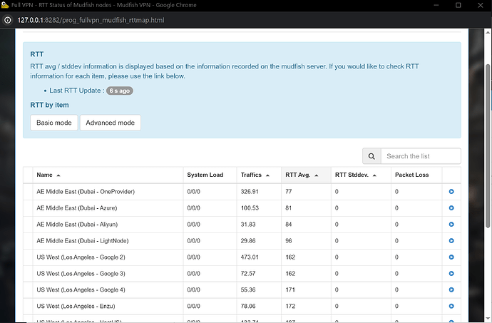

I’m not sure that you tried to check “Today’s Pathes” with “Include the result for the advanced mode” option enabled. It’s under ‘Setup → Nodes’ menu.

Hello. I have another question i encountered. I am using it with FULL VPN mode.
When I check RTT, i may see US WEST google 2 server to be about 162ms.

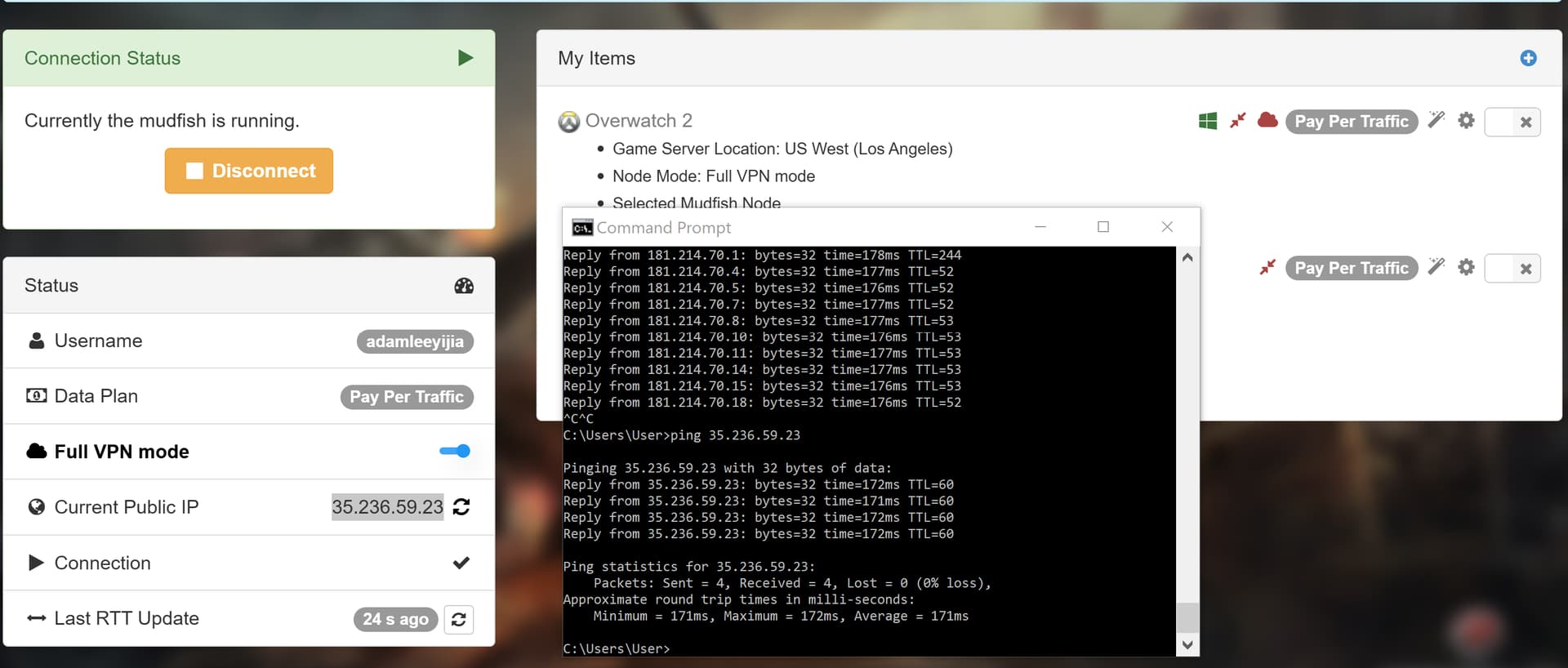

But when i connect to it and activate the service, i run a normal ping test, and the value is different. So which ping value is correct?

Which “RTT Checking Method” found at “Setup → Program” menu do you use? As you can see, if you test from Command Prompt, it tests using ICMP protocol. However if “RTT Checking Method” for example is UDP, Mudfish uses UDP protocol to measure RTT.
Thank you for answering. I checked and seem to be using TCP. What should I be using to check? And will it allow my RTT to be accurate when I do my ping test?
Thank you
If you want to match your ping between the result of Command Prompt and Mudfish, I think you can change the option to ICMP based. With ICMP based, I think it’ll become more similar with your result from Command Prompt.
However if the results between TCP and ICMP are different, it means your ISP or the upstream ISP has QoS (Quality of Service) rule on their network router. So I guess that it’s why TCP shows more less ping.
