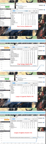

Please try to test your network status from your desktop to 195.82.50.13 (FFXIV: A Realm Reborn - Europe (Germany - Chaos)) using How to use WinMTR link.
I think this result shows you where this issue is from.

I have attached screenshots for you to better understand because I’m not too tech-savvy. I ran the program you mentioned earlier (WinMTR) with and without Mudfish running. Not sure if that would make a difference. If you need any more information to pin down the problem, feel free to ask, and thanks for your help :slight_smile:

When I checked your results of WinMTR, it seems the RTT is pretty high comparing your first result (Mudfish Off).
However please note that even if you tried to test with multiple mudfish nodes but still the pigh is higher than your normal internet. Then it means your ISP has enough good RTT to Europe. :slight_smile: For that case I think you can ask me the refund because you don’t need to use mudfish at all.
