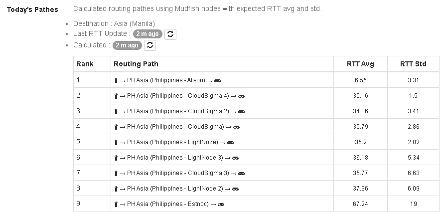

Good day. I am an everyday user of Mudfish and I do love the product. My only concern is that I live in Manila and the Manila nodes have 30ms ping on a Manila server. Only 1 node has the correct ping(around 6-9ms). My issue is that Aliyun’s ping is fluctuating. It often spikes to 40ms or higher but very briefly, this does not show up in my ping in game but I see it through the graph statistic of my ping. Is there a way that Mudfish can fix the RTT Std of Aliyun so that it does not spike all the time? And can Mudfish also fix the ping of the other Nodes so that it is sub-10ms because the ping should be sub-10ms in Manila.
Nodes with 30ms ping:
All CloudSigma
All lightNodes
Estnoc
Node with correct ping:
Aliyun

For this case, it looks like it’s out of control because this’s more related to the upstream ISP’s routing. It looks like your ISP has a good peering to Aliyun only.
Not sure where your spikes come from. It looks like we need to check it first. If possible, please try to test your network status from your desktop to 8.212.145.172 (the public IP of PH Asia (Philippines - Aliyun) mudfish node) using How to use WinMTR link. I think this result shows you where this issue is from.
