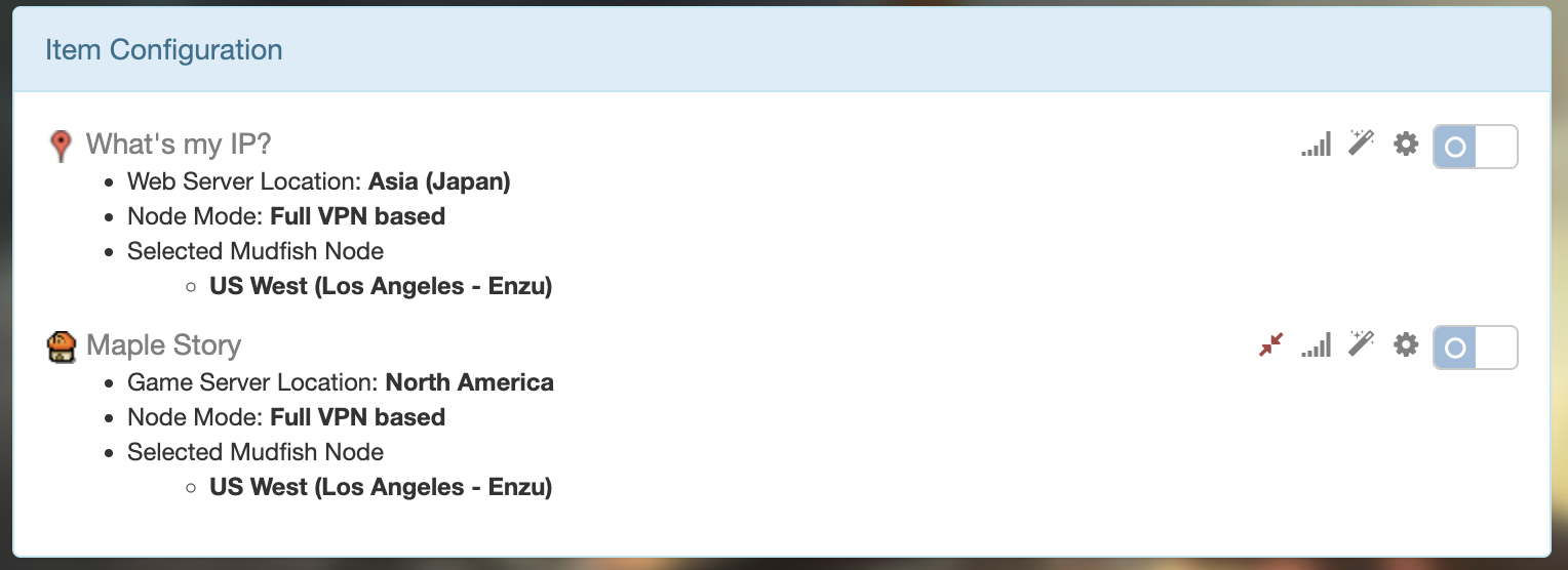

Hi, I’ve followed all instructions here to try and connect to Maplestory GMS from Singapore but can’t. I’ve turned on full VPN mode and fast connect. The basic functionality also does not work, it says that I’m accessing directing without Mudfish. Any help would be appreciated :")
Are you meaning that How to check the basic functionality doesn’t work on your machine? We need to fix this issue first before going further.

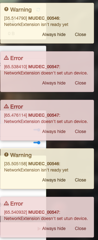

I’ve submitted the problem report, here are also the error codes I receive.
For this case, please check two things:
You need to make sure that 1) VPN profile is created for Mudfish 2) systemextension for Mudfish is activated properly.
