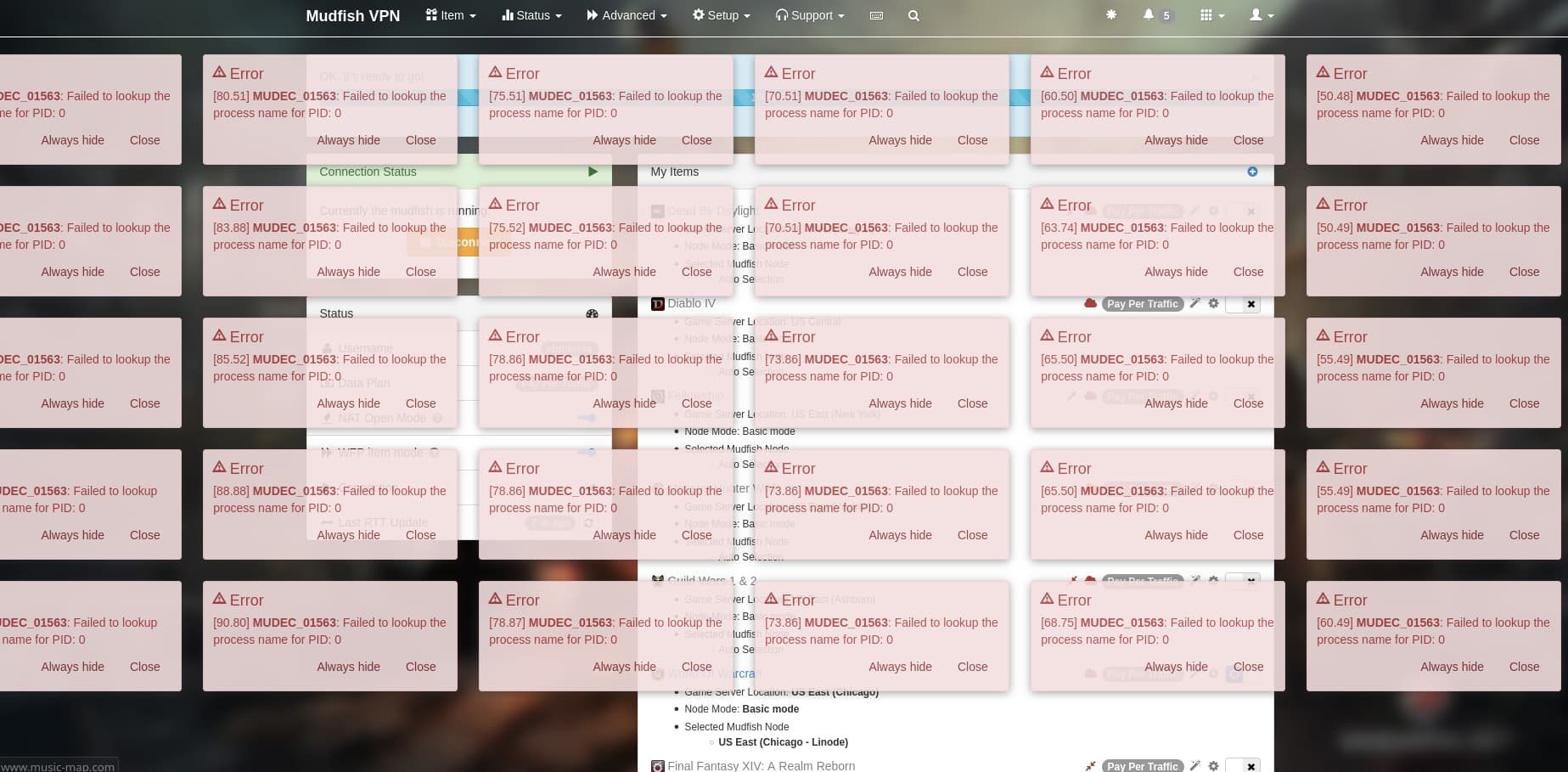

Mudfish is displaying this error MUDEC_01563: Failed to lookup the process name for PID: 0 I don’t know if it affects the connection to the node but I can’t see anything about MUDEC_01563 any ideas how to fix this?
@MasterRez Thank you for reporting the issue. It seems it’s not good. If possible, please install and test with v6.2.2 found at Index of /releases/ link. I think it’ll show different error code and messages for this case but it includes more details

Hey, Weongyo, after the day I posted that MUDEC_01563 it hasn’t come back ever since but I’m upgrading to 6.2.2 just in case.
