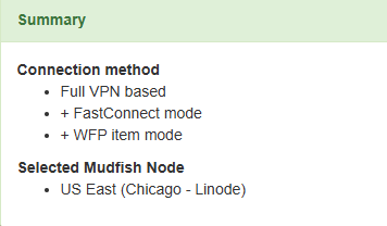

I live in Switzerland and I’ve been trying to use Mudfish to lower my ping when playing Minecraft on the Hypixel server (I’m located in Europe, and Hypixel is in the US). Unfortunately, I haven’t seen any improvements at all, my ping stays around 125–140 ms no matter what I try.
Here’s what I’ve tested:
  • Full VPN mode
  • FastConnect mode
  • WFP item mode
  • Various nodes (including the recommended ones and US East - Chicago Linode, as shown in the screenshot)
I also experimented with automatic and manually selected nodes, but none of the configurations had any noticeable effect.
