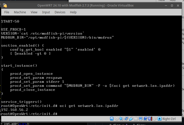

@markxman If you’re familar with SSH, please check the following things:
  • Checks TCP port 8282 is listening. I think you can use netstat -an command to see it.
  • Checks mudrun process is running using ps command.

While mudrun process does appear on the result below.

Something is wrong on your OpenWRT settings. What’s the result of uci get network.lan.ipaddr command? Here is an example from my machine:
However if I checked your router properly, I think it should show “192.168.1.1” instead of “192.168.1.1/24”.
That’s a reason why it’s trying to connect 255.255.255.255:8282.
Yup, change the network ip and got it working. Thanks a lot @weongyo
