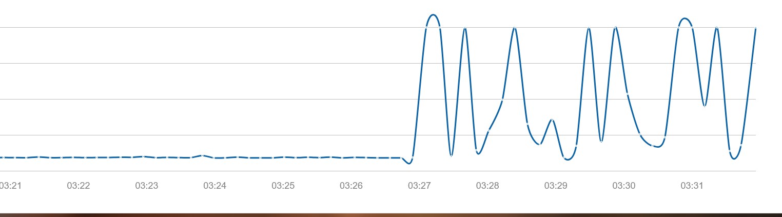

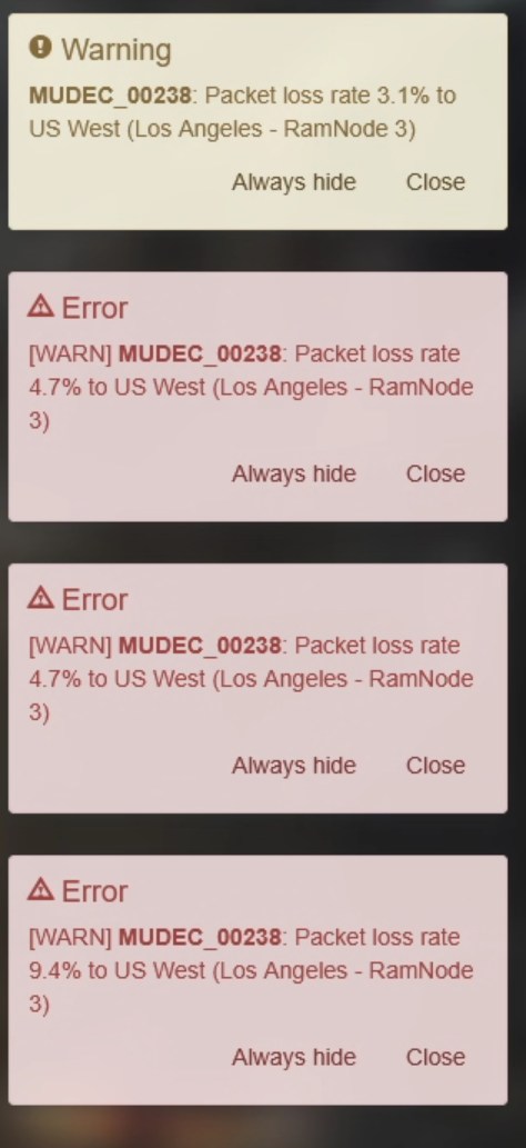

im having packet loss and connection drops to eve online. i am using advanced mode, and multi path mode, but doesnt seem to help. i have 3 PCs connecting independent, it seems to show US west or London with packet loss , i only captured the image showing US West, but it also pops up london. this doesnt seem to occur for any other game so im at a loss.
Hi, sorry about the disconnects. Please test one PC: open the EVE item, select Basic Mode and manually choose a different node, avoiding LA RamNode 3. Save, then restart EVE.
MUDEC_00238 indicates packet loss between your PC and the named Mudfish node.
If it persists, set logging to TRACE under Setup → Program → Launcher, reproduce the drop, then send a Problem Report via the dashboard’s pencil icon before closing Mudfish. Include the time/time zone and whether all three PCs disconnect together.
I turned off WPF mode and i think it stopped. for some reason maybe this could have a bug with it? Im not sure. but i have not had this packet loss message display since turning it off on 3 PCs.

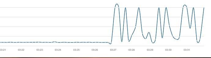

ok i was wrong, but no more MUDEC_00238 error, the packet loss now shows in the chart.
Hi there, thanks for the update. It is good to hear the MUDEC_00238 error stopped, but let’s investigate the remaining packet loss on the chart.
Please try to test your network status from your desktop to 141.101.71.6 (EVE Online - Europe (London)) using How to use Mudfish MTR link.
I think you need to do two tests; one without mudfish and another with mudfish connected. I think this result shows you more details where this issue is from.
