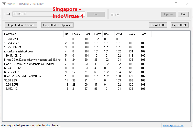

Please try to test your network status from your desktop to 43.152.113.1 (Delta Force - Asia (Singapore)) using How to use WinMTR link.
I think you need to do two tests; one without mudfish and another with mudfish connected. I think this result shows you where this issue is from.

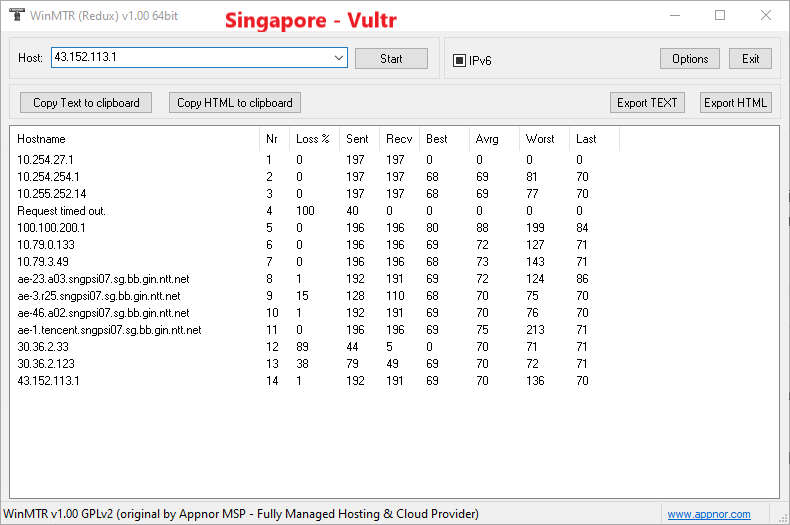

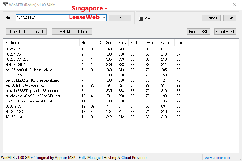

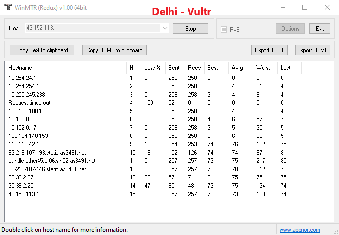

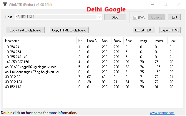

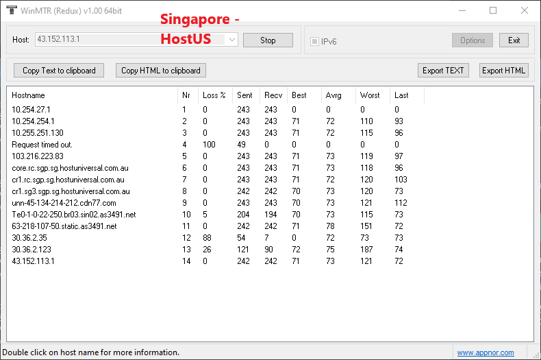

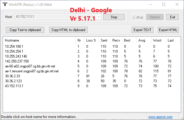

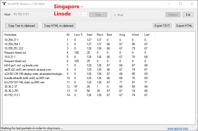

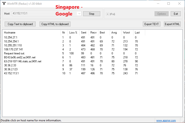

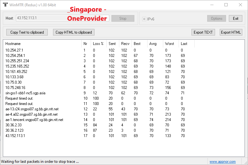

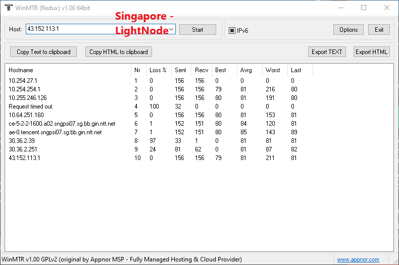

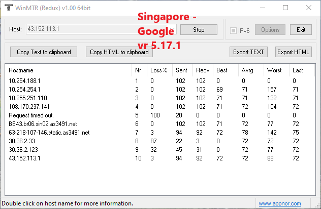

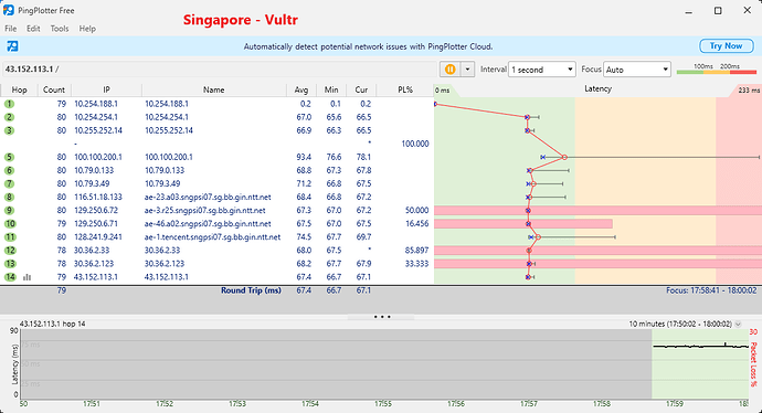

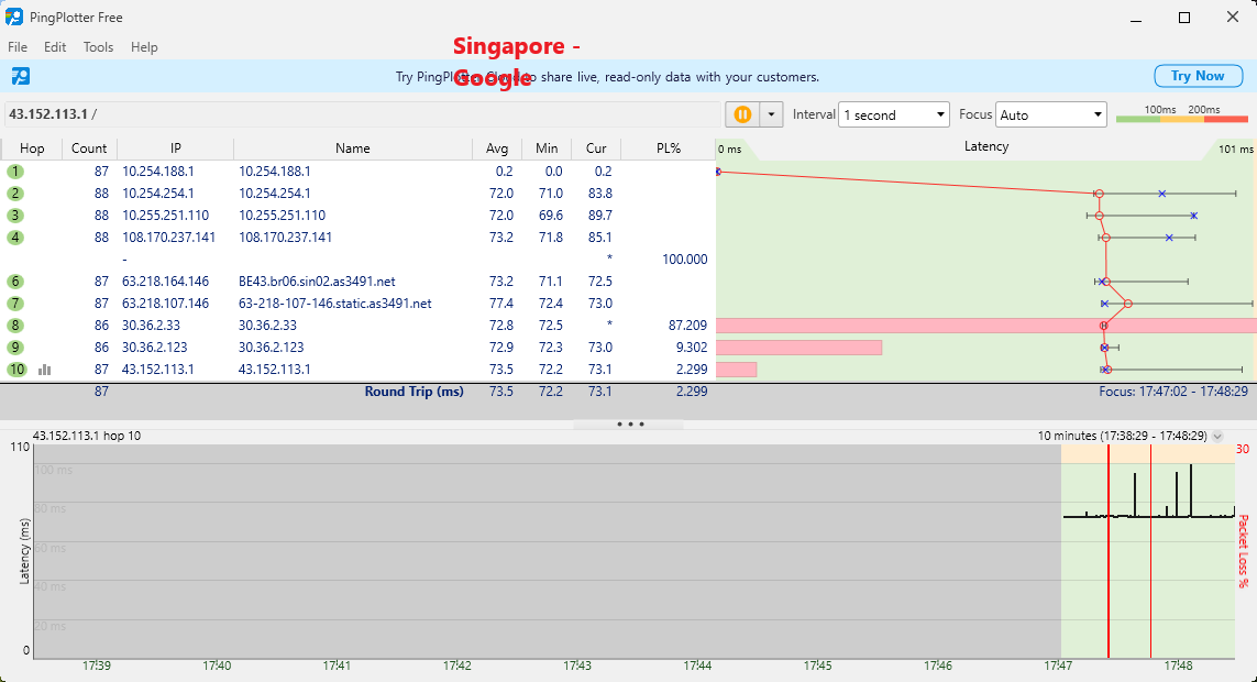

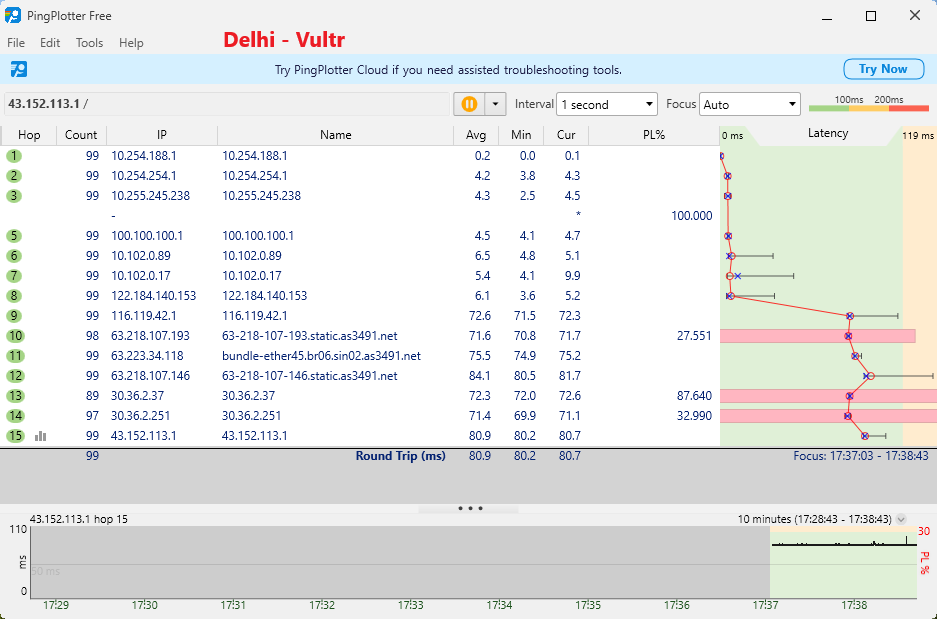

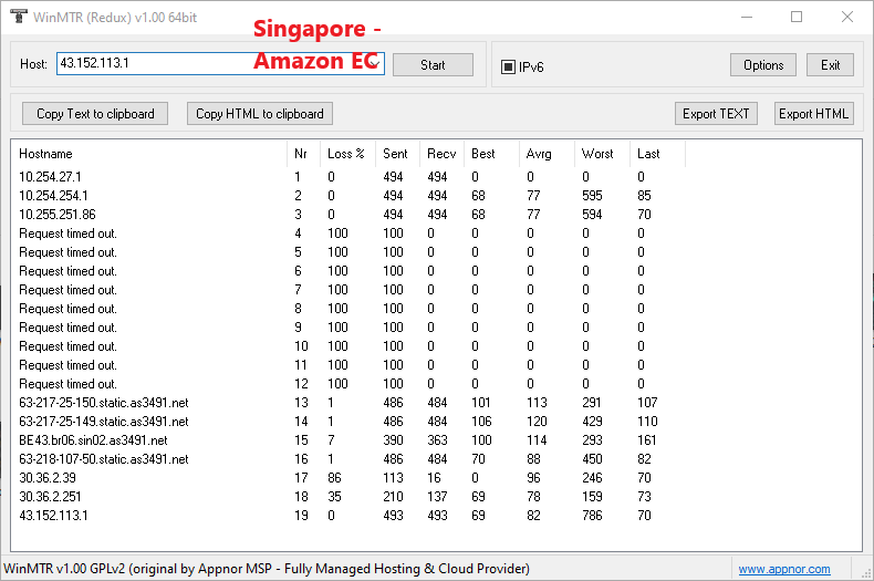

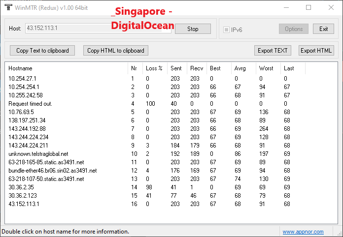

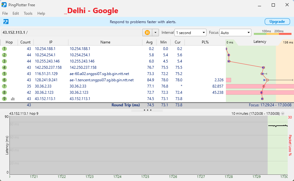

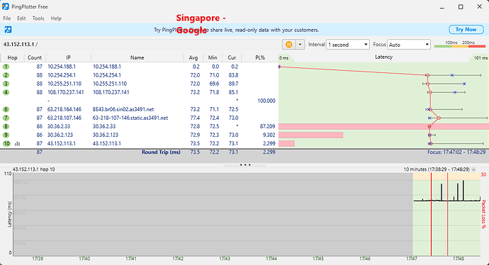

Hello Ma’am, I have attached all the screenshots for your reference. I live in Delhi so I have tested Delhi nodes and also most of the Singapore nodes for the game.
Connection method:- Item based + WFP item mode.
Items:- Delta Force
Node Mode:- Basic mode

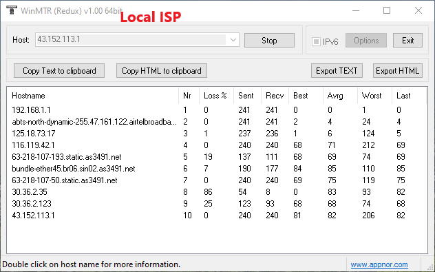

When using my ISP (without Mudfish) , WinMTR shows packet loss but I have experienced no such issues whatsoever whenever I play using my ISP. No packet loss, no ping fluctuations and no poor network shown at top right corner of game screen. When I use MudFish I see ping fluctuations, poor network notification on my game screen. This has started happening only recently. Last week this issue was not present.
@Perpetual8672 Thank you for these screenshots. When I reviewed this issue, at least I can’t see any issue between your ISP and the mudfish nodes.
It looks like this issue is more closer to the game server network or between mudfish nodes and the game server. So if this issue is still same with different mudfish nodes, at this moment I’m guessing that it’s more related to the game server network condition.
If it is related to game server network condition why don’t I experience this issue with my ISP? This is the question that has been bothering me. If the issue is with the game server itself shouldnt it be the same with when using my ISP? I’m also wondering if this issue has to do with the recent mudfish update because the issue kind of began around when I updated mudish. I’m going to take this issue to Delta Force support to hear what they have to say in this. Hopefully something good will come out. My ISP sometimes gives me high ping so whenever that happens I use Mudfish but I havent been able to since this issue showed up.
No idea for this case because the WinMTR result from your local ISP also points that there’s a problem your ISP level and the game server network. Might be that WinMTR result isn’t accurate enough to show us the culprit.. :-1:

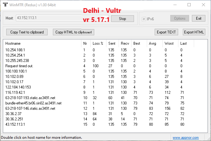

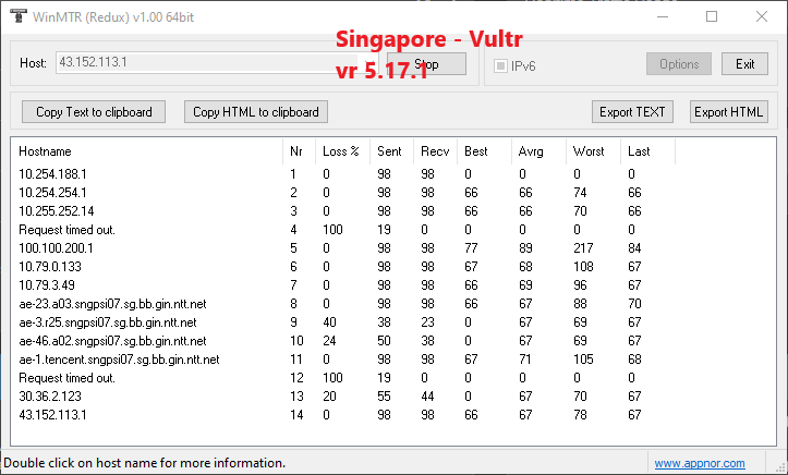

Hello Ma’am,
As per your suggestion, I downgraded from Mudfish v5.17.3 to v5.17.1. As a result the issue has gone completely no ping fluctuations, packet loss and poor network condition is being shown on game screen anymore. I have tested with 4 mudfish nodes and I have found no issue with any of them. This is safe to say that the issue lies somewhere in Mudfish Client.

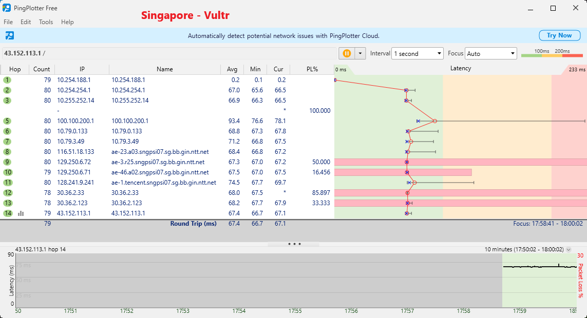

Regarding WinMTR result accuracy I don’t think something is wrong with the program as I have tested the same issue with a different program called PingPlotter and found the results to be same.
