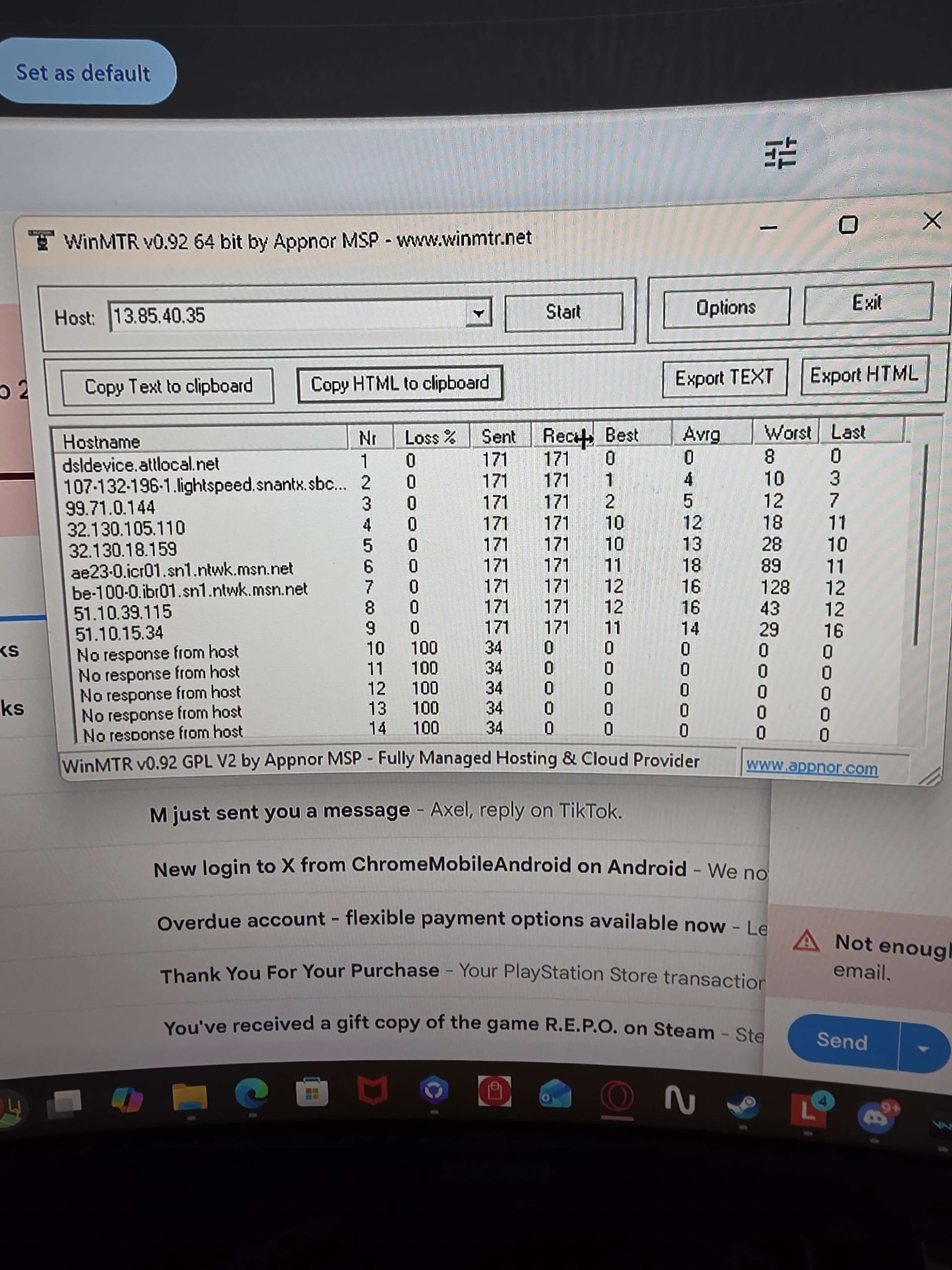

I am experiencing severe latency spikes and 100% packet loss when using the Mudfish VPN for Roblox: The Strongest Battlegrounds. The issue only occurs when Mudfish is running. I have already adjusted my MTU settings and tried different nodes, but the problem persists.

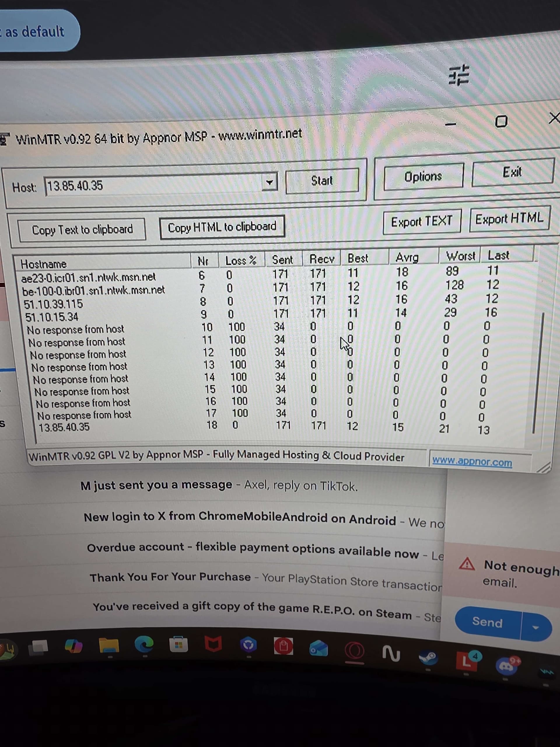

I ran a WinMTR test to the Dallas TX Azure node (13.85.40.35) and found that all packets are being dropped starting at Hop 10.
Here is my full WinMTR report:

If you see a row which points Loss 100%, you need to ignore it because it means that there is a hidden router but not visiable. When I checked this result, I can’t see any packet loss which doesn response.
However it looks like 13.85.40.35 points US Central (Dallas, TX - Azure) mudfish node and good to use at least between your PC and the mudfish node. However as you know, this result doens’t show the status between the mudfish node and the game server.
Do you know the game server IP? If then, I recommend you to test against to the game server IP.
