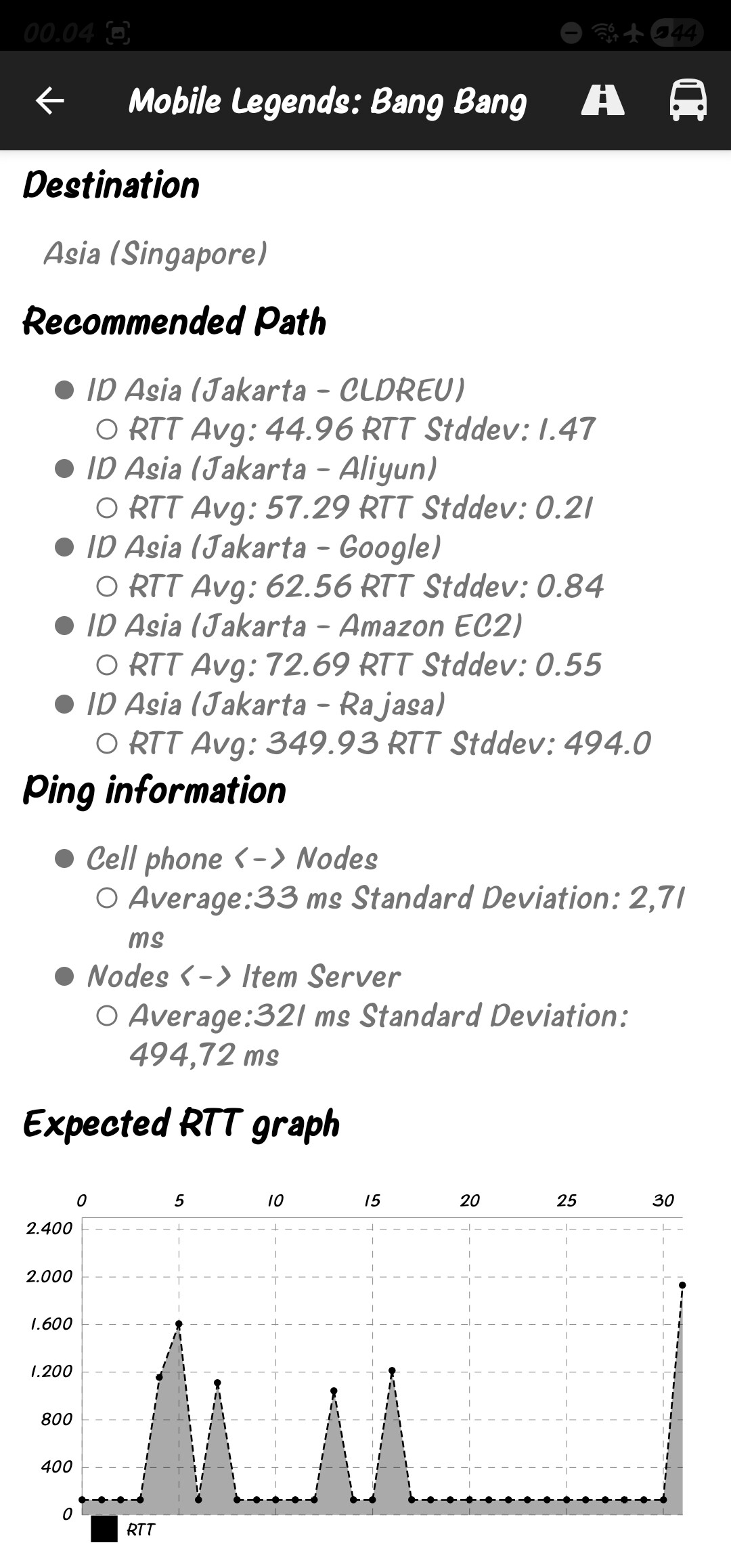

I am a user from South Kalimantan, Indonesia. Currently, the “Mobile Legends: Bang Bang” item only provides Singapore destinations.
For users in my region, routing through Singapore significantly increases latency (high ping). However, the game has local servers in Jakarta which provide much better latency for us.
I really like Mudfish’s “pay-per-traffic” system and I would love to recommend this app to my friends and the local community. However, the current routing is still too far and inefficient for us because the Jakarta destination is missing.

I would like to add more evidence on why this Jakarta destination is urgent.
As shown in my dashboard screenshot (attached), my Cell phone to Node latency is very good at only 33ms (South Kalimantan to Jakarta). However, because the destination is forced to Singapore, the Node to Item Server latency jumps to a terrible 321ms.
This confirms that the current routing is sent to a very far location instead of staying within Jakarta. Adding the Jakarta destination would fix this instantly. Thank you."

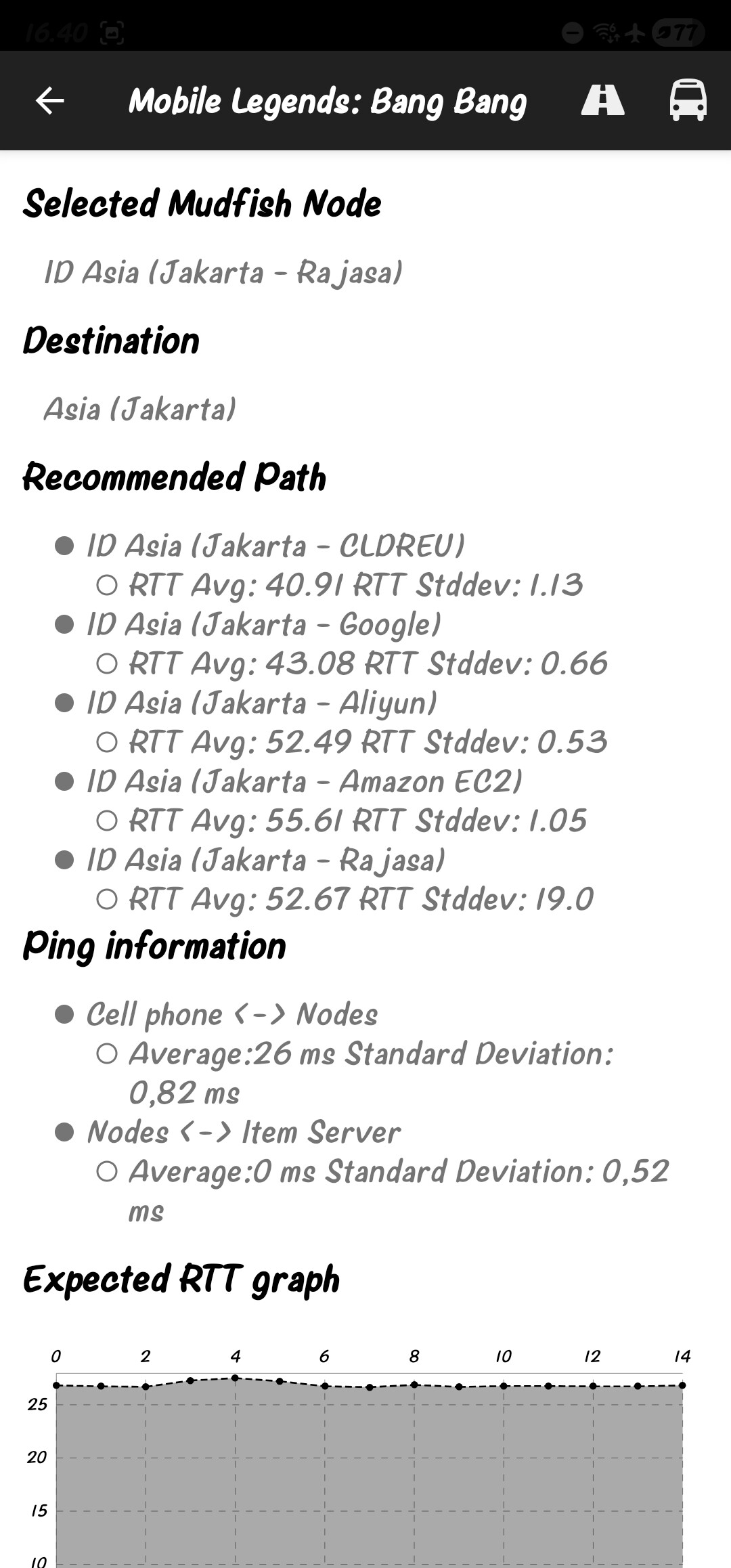

Okay. Based on your IP information, I’d tried to add “Asia (Jakarta)” destination. When you get a chance, please check it again.
Thank you! I have tested the Jakarta destination and it fixed my routing issue. My ping is now very stable. I will definitely recommend Mudfish to my friends in the local community here. Great job!

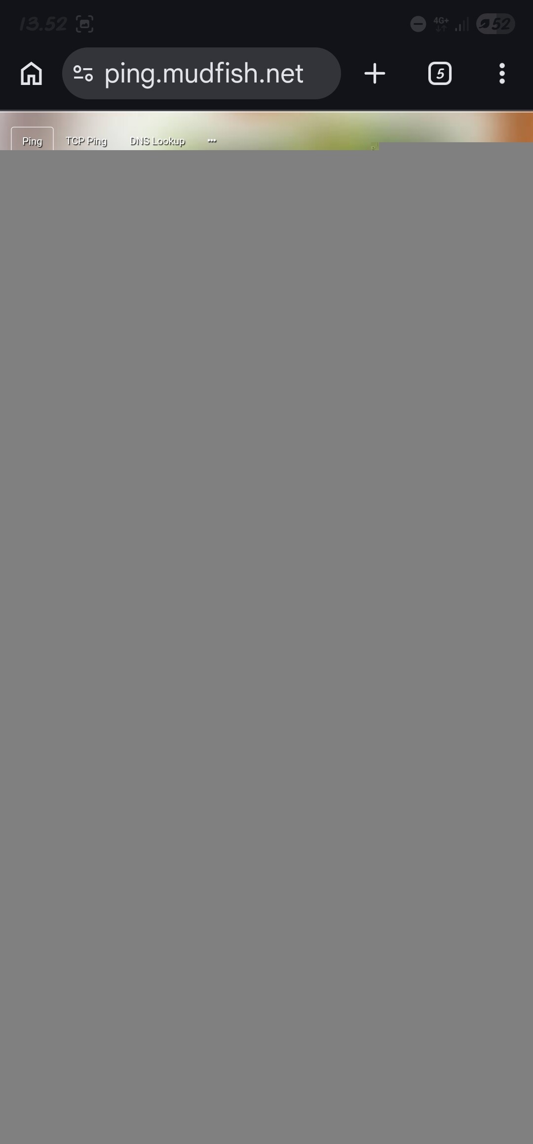

I checked through ping.mudfish.net and the RTT from Jakarta nodes to 103.155.16.40 is still around 12-14ms. This means it’s still routing through Singapore. If it’s already optimized, it should be 0-2ms. Please double check the CIDR routing for Jakarta nodes.
I appreciate the update, but I’m still seeing high RTT on several blocks. To prove that these IPs are physically in Jakarta and should be 0-2ms, I compared them using ping.mudfish.net.
Please look at this comparison:
  1. The “Correct” Route (Already 0-2ms)
    These IPs are working perfectly, proving they are in Jakarta:
    156.59.79.98 (Zenlayer) → RTT: 1-2ms from Jakarta Nodes.
    103.157.33.107 → RTT: 1-2ms from Jakarta Nodes.
    (This is the gold standard we are looking for).
  2. The “Leaking” Route (Still 12-14ms)
    These IPs (from the list I sent) are still routing via Singapore despite your update:
    103.155.16.40 → RTT: 12-14ms (Verified via ping.mudfish.net)
    148.153.x.x blocks → RTT: 13-15ms
    45.198.x.x blocks → RTT: 14ms
Since some IPs in the same subnet/provider can achieve 2ms, it proves the 14ms ones are just “misrouted” to Singapore.
Could you please re-check the BGP routing / Static routes for the CIDR blocks I provided? They should all be hitting the local Jakarta peering, not hairpining to Singapore.
Thank you!
