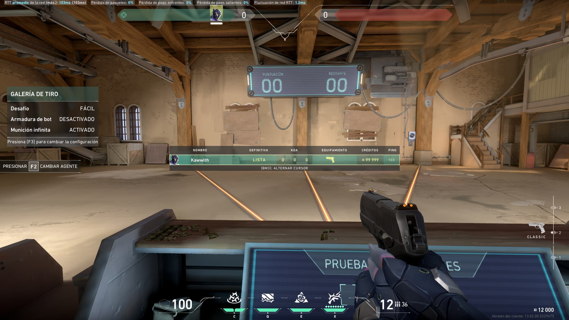

Hello Mudfish Support,

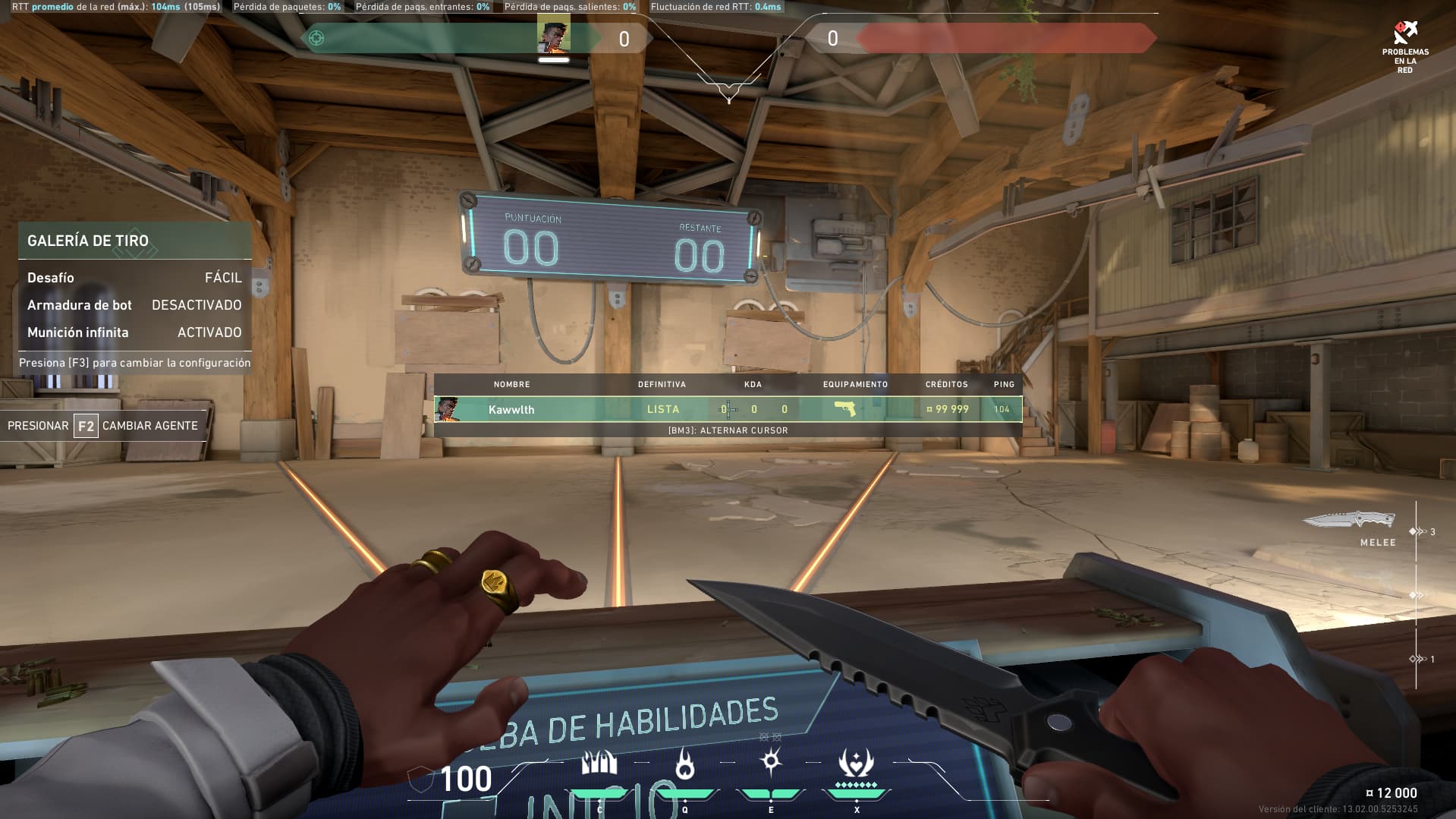

I am experiencing a major routing issue when trying to play VALORANT on the Mexico City server using Mudfish nodes located in Mexico.
  • My native ping (No Mudfish): ~19 ms (Direct connection through my local ISP via Riot Direct).
  • Ping with Mudfish enabled (MX Nodes): Spikes to 104 ms.
The Problem:
I have tested all three available Mexico City nodes: Amazon EC2, Azure, and Vultr. With all of them, my ping goes above 100 ms inside the game.

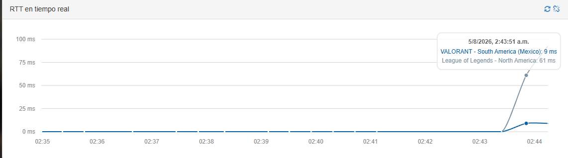

The real-time RTT graph inside the Mudfish dashboard incorrectly shows a perfect 9 ms to the game server. However, my local ISP is routing the traffic from my house to a US exchange point (likely Dallas or Miami) before sending it back down to the Mudfish nodes in Mexico City.
This inverted routing breaks the optimization. Competitor software like ExitLag manages to route directly to Mexico City keeping the ping at 22 ms, which confirms that a direct local route to these cloud providers is possible but Mudfish’s current routing tables are forcing a US detour for Mexican ISPs.
Could you please look into the routing path or update the VALORANT item IP blocks for the Mexico region? I am attaching screenshots of my game ping and the dashboard RTT graph.
Thank you!
First, please take a look at this link: http://ko.loxch.com/userrtt/?uid=1694689. The results show that the ping between your computer and the Mudfish Mexico node is around 7 ms.
This is a great ping, meaning there are no issues between your PC and the Mudfish server. If you are experiencing 104 ms in-game, it indicates a routing issue between the Mudfish node and the game server itself.

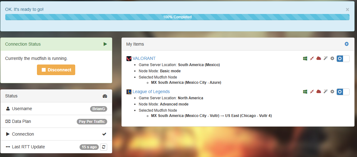

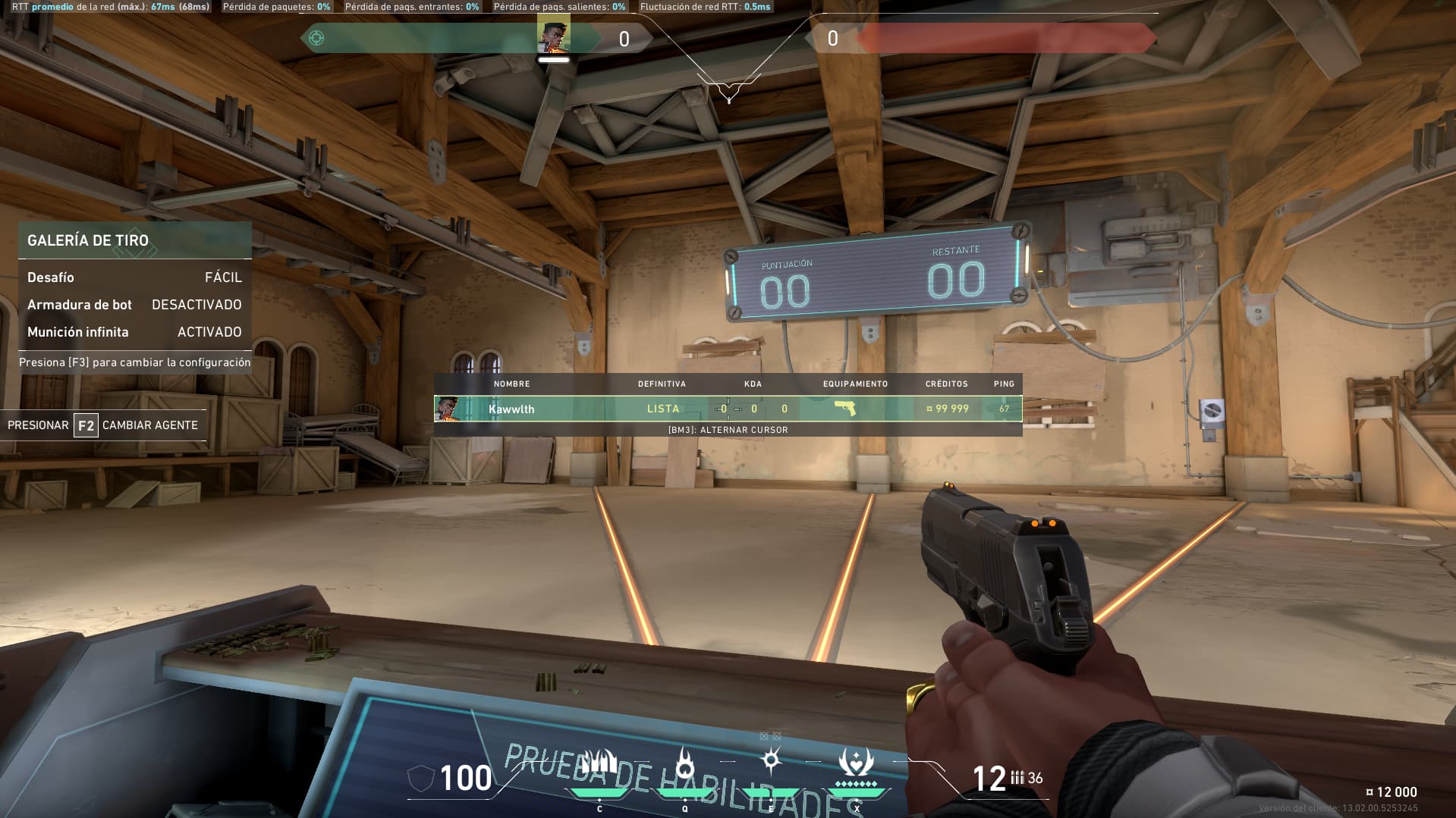

I just completed the test in Full VPN Mode using the MX South America (Mexico City - Azure) node as requested.
The results are positive: the in-game ping dropped from 104 ms down to 69 ms, and the connection is stable. This confirms that the Mexico City Mudfish node is physically capable of reaching the Riot game server properly.
However, when using the regular Game Item Mode, the ping spikes back to 104 ms. This proves that the pre-configured VALORANT Game Item routing tables for the Mexico region are outdated or broken, causing a detour through the US.
Could you please update the destination IP blocks for the VALORANT item in the Mexico region so it reflects the correct routing found in Full VPN mode?
