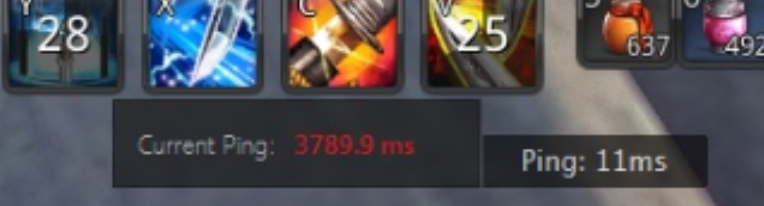

I am having problems with massive ping spikes and only notice when im ingame.
I have 2 Ping Overlays set up. The left one pings the BNS Server that im Playing, the right one pings a dedicated server that I know is stable from my country.
https://i.gyazo.com/ff9531fb7d8def5bf8c237935bf743bc.png
https://i.gyazo.com/8f250c0854ae6e337dd8f046e34f1ad2.png
Its not my ISP, not this time.

I showed my friend a almost a week ago a this screenshot without > with mudfish (Leaseweb)

It comes and goes and sadly I dont know why. But its pretty clear that as long as I close mudfish the problem goes away (when its hapenning), as you can see from the fist screenshot.

Is it still same? It seems this issue was caused by outage of Mudfish service happened at Oct 10th, 2017. :frowning:
