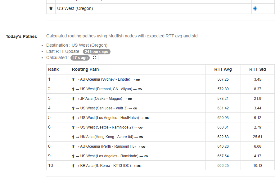

The ping issue in US West that I posted in December 2025 has returned. Connecting without full VPN mode results in up to 300 ping.

Could you please confirm that it’s also same with Full VPN mode enabled? If it works fine with Full VPN mode enabled, it means there’s something a problem in the game item of Mudfish.
For that case, I need to collect some game packets using Packet Capture with Mudfish.
Hello, the full VPN mode is fine, I will run packet capture and upload it, if the upload does not work I will send it via email.

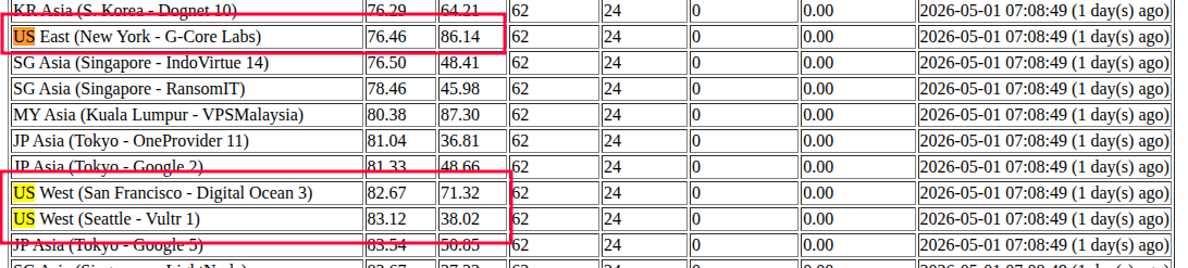

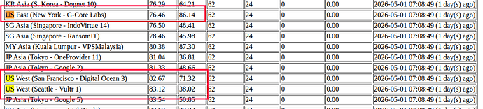

@GoodnightBug When I reviewed your RTT information which recorded at Mudfish side, it looks weird. You can see it at http://ko.loxch.com/userrtt/?uid=366162 link.
As you can see, RTT between your router and US mudifsh nodes is too small while RTT stddev is pretty high:
So it’s not easy to trust your RTT measurement result in my opinion. Could you try to change ‘RTT Checking Method’ found at ‘Setup → Program’ menu and test it again?
