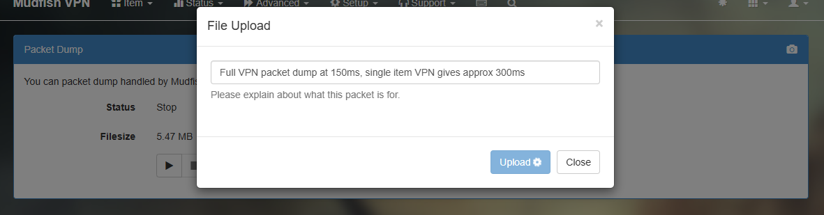

I will record packets, where should I upload? Full VPN gives approximately 150ms on ping, which is about 10 higher than when it is running normally.
There’s a upload button at the packet capture menu. :slight_smile:
Hello, I should have uploaded it, but I can’t find it in the forums.
Umm.. If you tried to upload but you can’t find a packet dump topic in your private support, it means it failed to upload at somewhere…
For this case, please send us another packet dump if possible..
I have encountered an internal error during the upload.
:frowning: Not good. If then could you please send it to us manually? For details, you can find it at the document link.
I have sent the packet dump via email to support@loxch
:slight_smile: Thank you for sending the packet dump. Based on your packet dump, I had updated the game item. Could you please test with it? If it is not working properly, please let me know.
Hello, it seems like the issue has been resolved. Thank you very much for the help.
