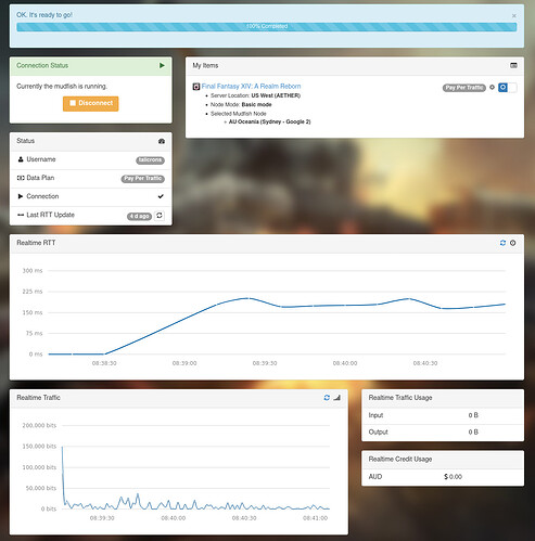

I’m using Manjaro 5.4. After I turn it on it looks like
and then after a while it says there was a problem loading this page and the Item disappears.Netstat:
